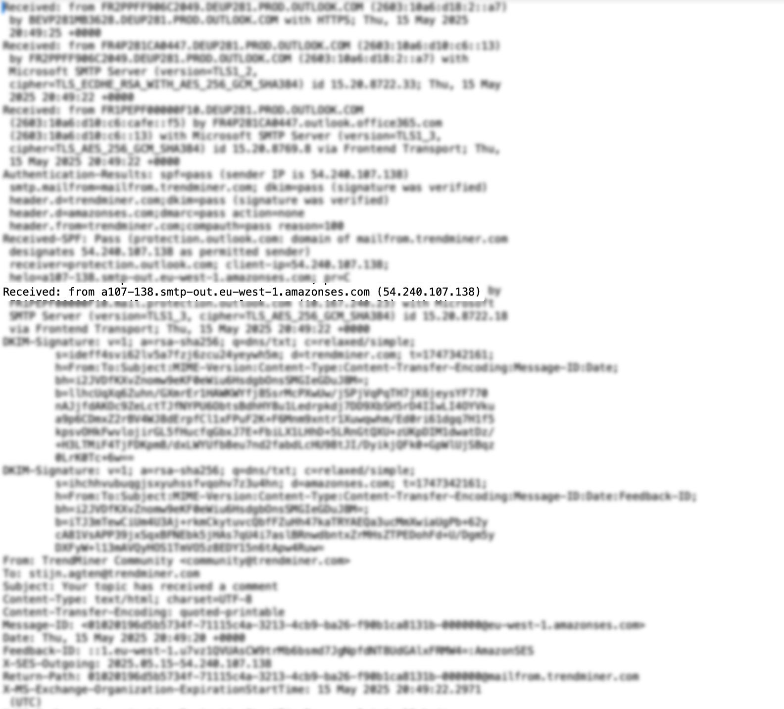

Thank you for your feedback. We agree this would be a nice improvement and we would encourage you to share your ideas for features and improvements with our product team such that they can take it into account for our product roadmap. The process to log and upvote ideas is explained here:
As a workaround you could also check the source of the email (in Outlook right click on the mail and select ‘view source’).
In the mail headers you can see which server sent the email.
