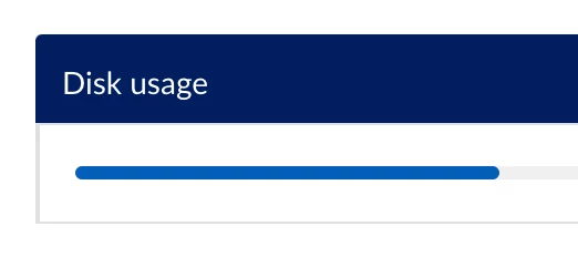

In Edge Manager → Diagnostics the available disk space and the total disk space of TrendMiner can be checked. The disk space shown there shows the space on the /mnt/data volume (the volume on which the TrendMiner appliance is installed and on which TrendMiner stores its data).
Next to the /mnt/data volume there is also the root volume, on which the OS and system services are running. Both the root volume and the /mnt/data volume can run out of disk space which in both cases will result in service interruption.
The root volume total disk space and usage is not shown in Edge Manager since TrendMiner does not actively use this volume. Disk space issues should not occur on this volume if the system requirements are met.
