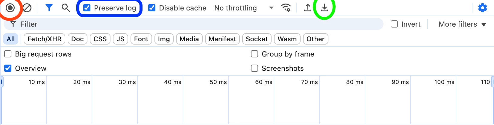

  • Press F12 or ctrl + shift + I (Windows)  or cmd + option + I (Mac) to open Developer Tools.
  • Click on the record button on the top left (red circle) in the below example screenshot (record network log).
  • Make sure the ‘Preserve log’ (blue rectangle) option is enabled.
  • Recreate the issue in TrendMiner.
  • Click on the download button (green circle)
