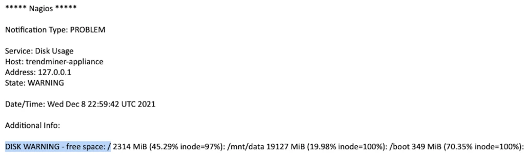

Case 1: Disk Alert for ‘/mnt/data’
Description:
A warning alert is triggered when the /mnt/data mount — which stores most of TrendMiner’s critical application data such as indexes, packages, logs, and databases — exceeds 80% usage.
For email alert example, you might receive an message indicating that only 19.98% (19,127 MiB) of space remains available as shown below.
Recommended Action:
Follow Disk space extention guide to extend storage. Expanding storage ensures TrendMiner can continue to write data and perform indexing operations without interruption.

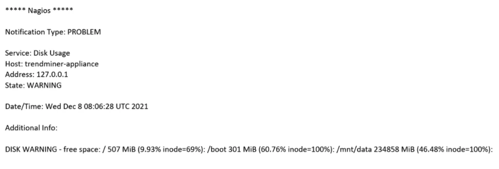

Case 2: Disk Alert for Root Directory ‘/’
Description:
A warning alert is also raised when the root directory (/), which holds the server’s system-critical files — including boot files, binaries, configuration files, and temporary data — reaches 90% usage.
For email alert example, you might receive an message showing only 9.93% (507 MiB) of space remaining as shown below.
Recommended Action:
Contact TrendMiner Support to investigate the cause of the root directory filling up.
