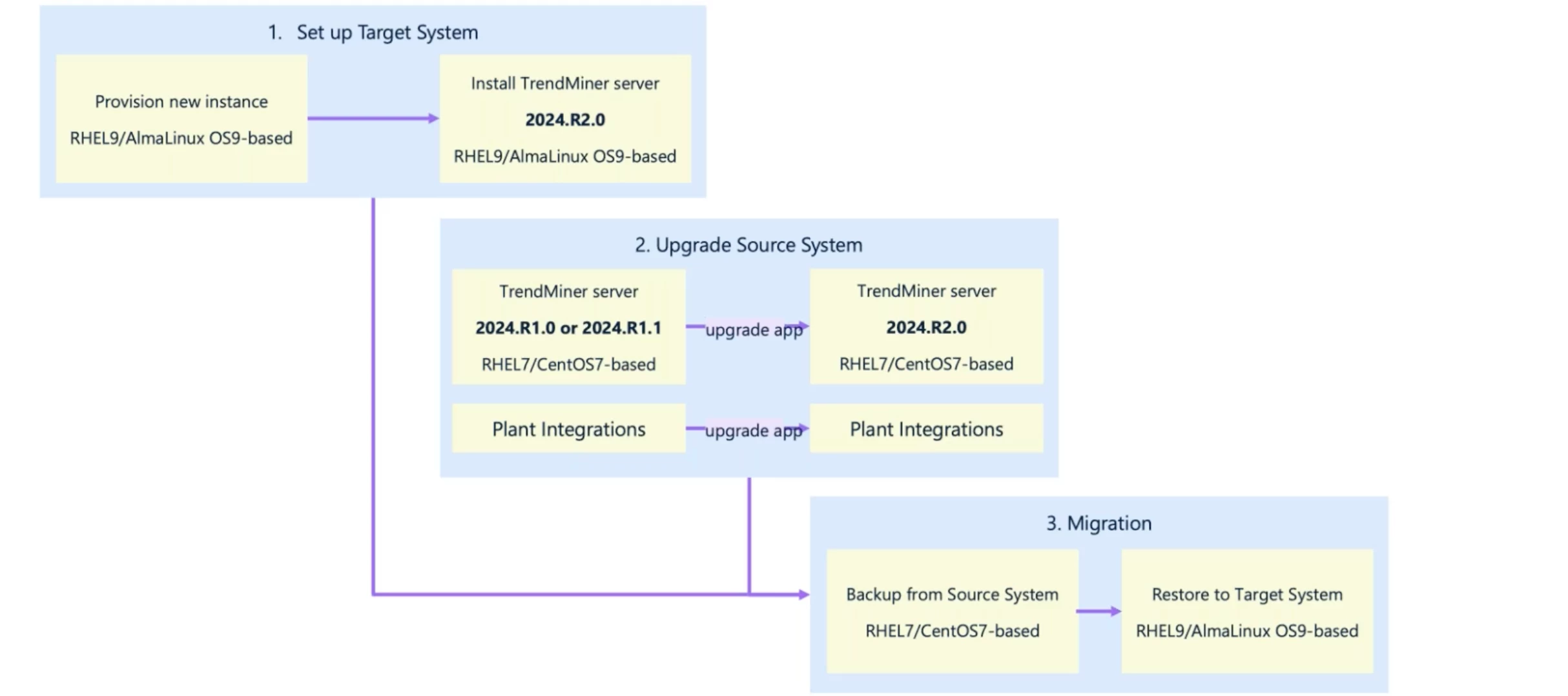

On June 20th, we hosted an admin webinar to prepare our admins for the upcoming 2024.R2.0 TrendMiner release. With this release, we are moving to a new Operating System (OS) given the end-of-support for Red Hat Enterprise Linux 7 (RHEL 7) and the derived CentOS 7.
Two actions will be needed to upgrade your TrendMiner setup to version 2024.R2.0 once it is publicly released:
  1. The creation of a new TrendMiner server based on the new OS
  2. A migration of the application data to the new server
This webinar details the prerequisites and steps to be taken to complete these actions.
Additionally, it explains the migration options, including the new and highly recommended full system backup/restore functionality with secure storage on your own AWS S3 or Azure Blob Storage, which includes index migration. A detailed demo of this process is provided.
Finally some important considerations and recommendations for planning the migration are outlined.
