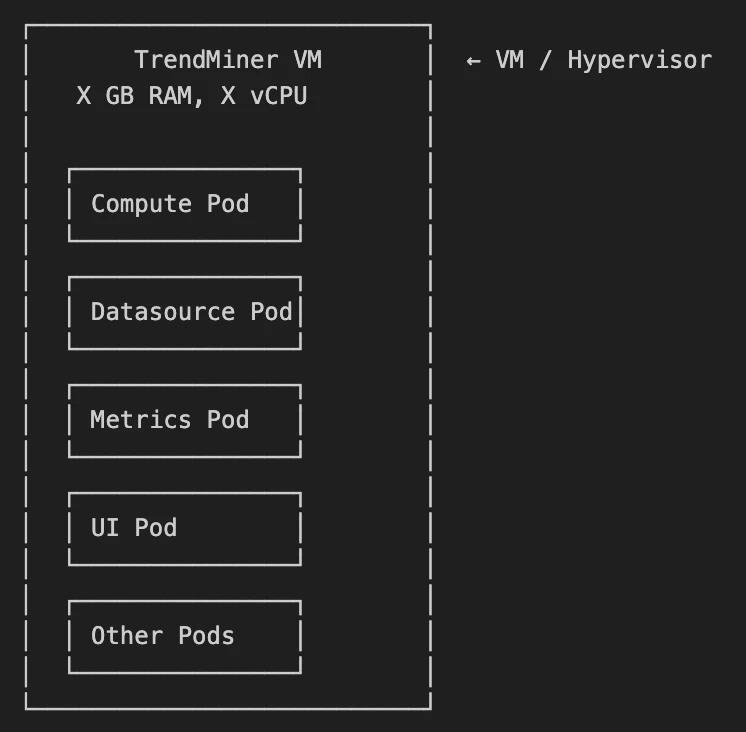

Visualizing the TrendMiner VM
Below is a simplified view of a TrendMiner VM hosting multiple microservices pods:
Each pod acts like a mini-VM running a single microservice. The TrendMiner VM acts like the hypervisor, guaranteeing resources for all pods at all times.
