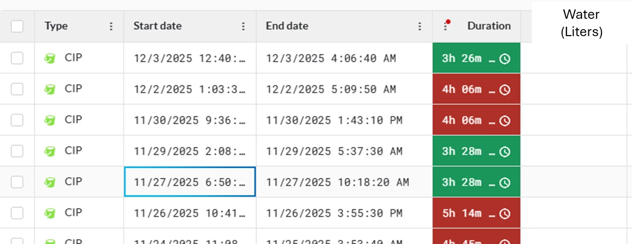

Is it possible to add aggregation results in a context table? For example, I would like to have a table with all the cleaning registered in the last month with the resources consume such as water, chemicals, steam, etc. I can calculate the volume of these resources consumed with the integral aggregation, however I cannot add them in a context table. How can I add it.
Column of water added for explanation proposes.
