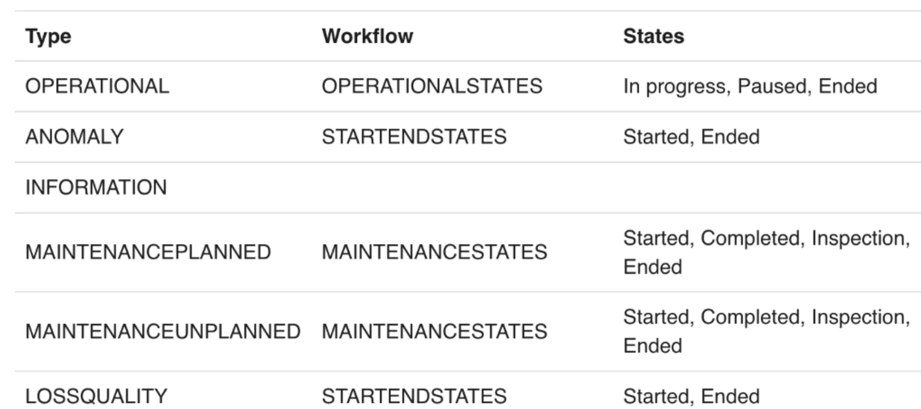

There are several pre-loaded Types  in TrendMiner as shown below:
Each type has an associated workflow, or group of sequential steps that describe the evolution of a particular event. The steps in the workflow are detailed in the states column. In the example of the filter change, the pre-loaded Maintenance Planned type can be used to highlight the reoccurring event.
