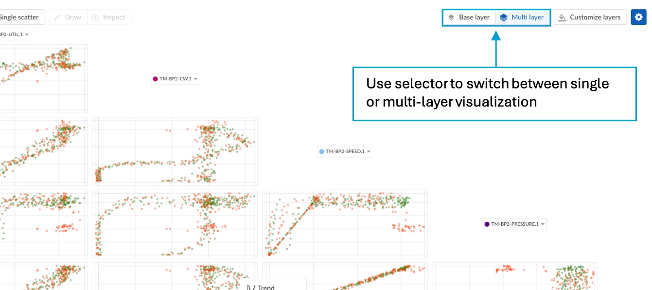

By changing the plot visualization to a scatterplot, you’ll immediately see the option to create a multi-layer scatterplot.
Scatterplot visualization with multi-layer enabled
