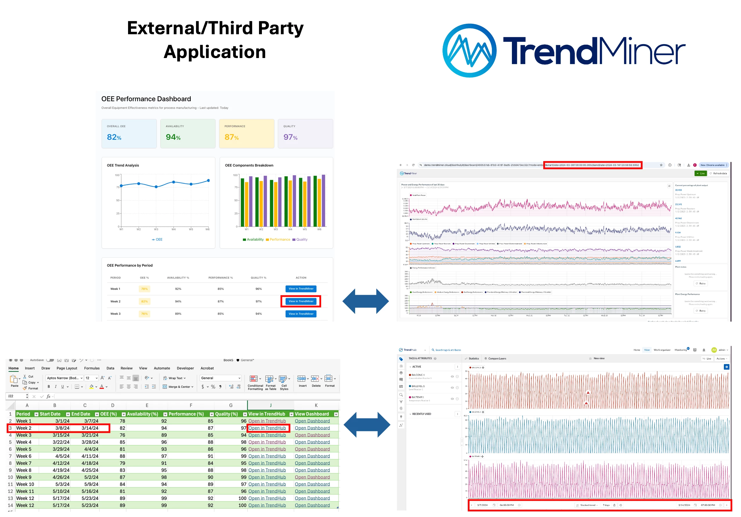

Bridge the gap between identifying issues in your enterprise applications and analyzing the underlying process data, cutting troubleshooting time dramatically.
Create a linkage between your external applications and TrendMiner by dynamically creating a URL to either a Dashboard or a TrendView with a pre-populated timestamps and process tags.
Following the structure below to create URL Link to a (1) Dashboard or (2) Trend View.
Dashboard Embed:
https://your_trendminer_url/dashhub/dashboard/123?embed=true&startDate=2025-09-16T14:05:17.590Z&endDate=2025-09-18T14:05:17.590Z
TrendHub View:
https://your_trendminer_url/hps/index.html#/chart/externalView?start=1709856000000&end=1710374400000&tag=tagname1&tag=tagname2&tag=tagname3
