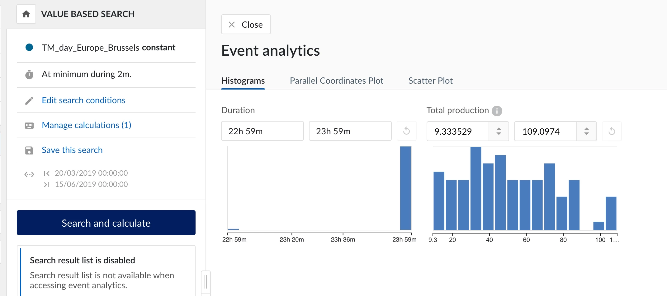

2. Using Calculations on Search Results
When analyzing consumption or production across multiple time periods, you can calculate metrics through the search results in three steps:
  1. Feature Search: Use value-based or other search options in TrendMiner to identify the time periods for analysis. Tip: use the TM_day or TM_hour tags to search for periods of exactly one day or one hour to get daily and hourly consumption/production values.
  2. Calculations on Search Results: Select “Add Calculation” for your search results and calculate metrics like the integral or average value, depending on the available tag.
    Note: TrendMiner does not interpret the unit.
  3. Event Analytics: Use the Event Analytics section to refine your search with histograms or parallel coordinate plots, selecting specific periods. Filtered results can also be exported to Excel. Save your search and calculations for future analysis, allowing you to repeat it any time by reloading the saved search.
Histograms in Event analytics to see the spread on total daily production
