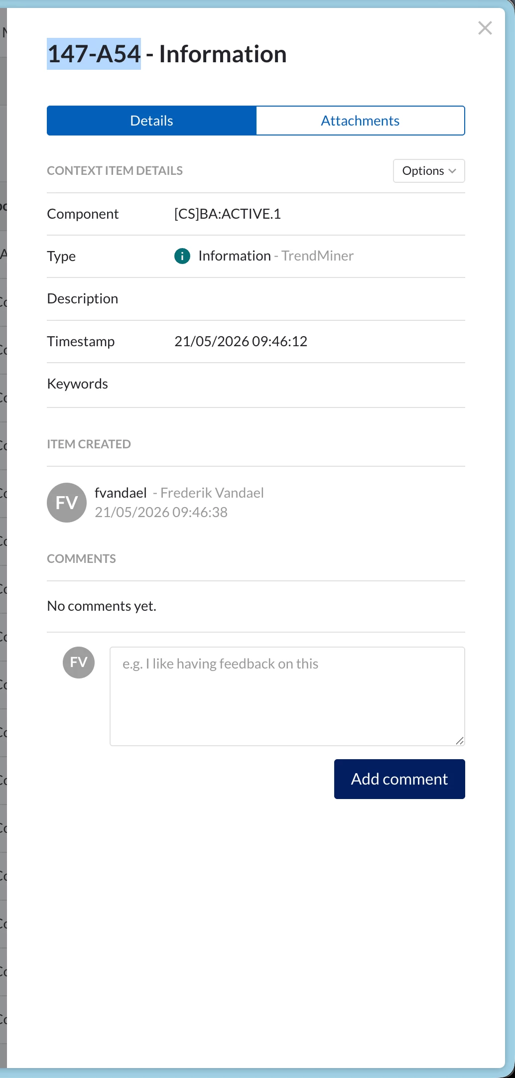

There isn't a way to add the short ID directly to a specific context item field, but it is displayed in the title when you open a context item. The ID I selected is the short ID of a context item, making it easily accessible — though it isn't editable in that form. Alternatively, you could add these analysis IDs to a keyword field, which would also make them non-deterministic.

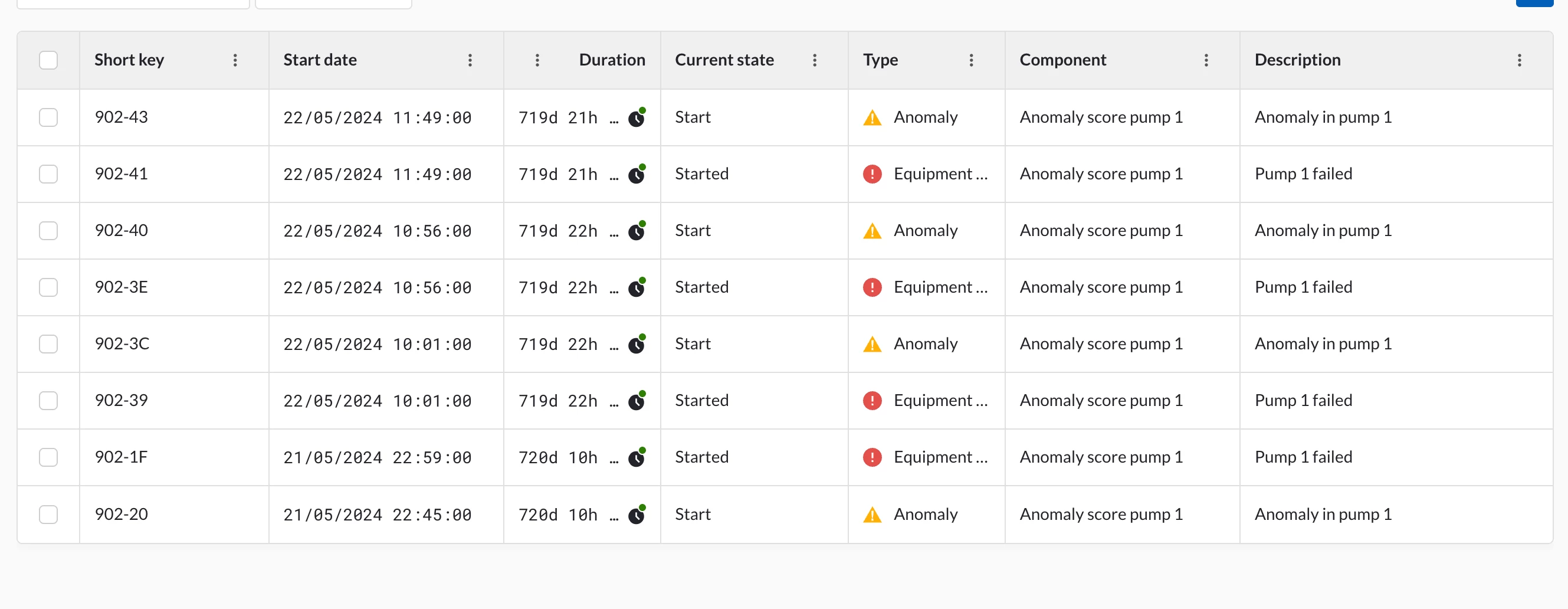

The uuid you cannot view in a context field, however in a ContextHub view you can add a column with a short-key, This short-key is also unique to a context item and can be added as a separate column in a table view.
