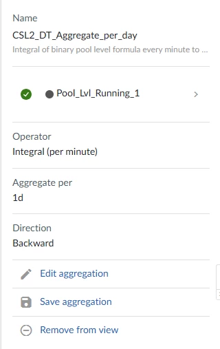

Hi Kevin, following these steps yields me the result of “This formula can't be saved because it exceeds the maximum number of allowed levels (2) in a formula” when I attempt to save. My aggregate tag is set up as follows where the Pool_Lvl_Running_1 is an if statement if the pool level is above 30% to return a 0 if true and a 1 if false to indicate downtime:

Hi ​@benjamindavis
There is a limit on the number of nested calculated tags (i.e., formula/aggregation/… tags used in another formula/aggregation/...), which is currently set to 2 levels. As you’re trying to create a formula on an aggregated tag that is based on another formula, you’re adding a third level.
The good news is that our development team is working on allowing more levels for tag builder tags, which should become possible in one of our next versions. In the meantime, the custom calculations functionality (part of the expert license) provides more flexibility in configuring calculated tags and would make this use case possible as well.
