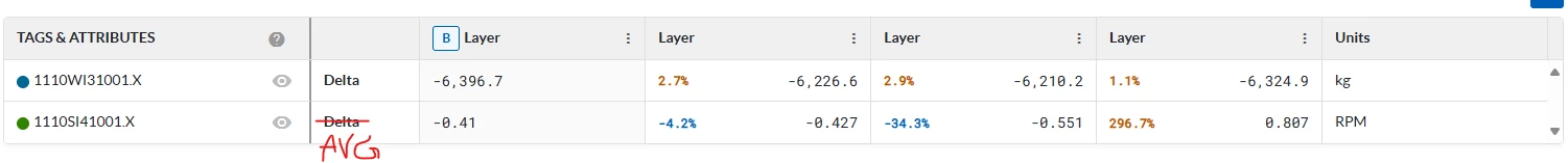

Is there a way to select different key parameter for every row, when I do a layer comparison?
I would need “Delta” for the first row and “Average” for the second row
BR Peter

Hello ​@Peter Mayr,
Unfortunately, this is not possible at the moment.
I’d recommend posting it in the Product Ideas section of the Community so our product team can consider it for future updates.
Tip: If you export the compare layer table, you’ll get all statistical parameters for all tags in your active tag list, available across the different Excel sheets.
