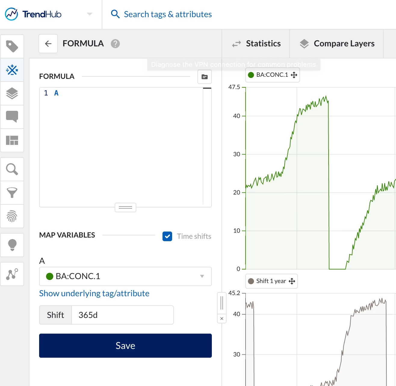

It’s not possible to add the same tag multiple times to the same view. However, you can create a duplicate, and shift it by 365d, 730d etc.

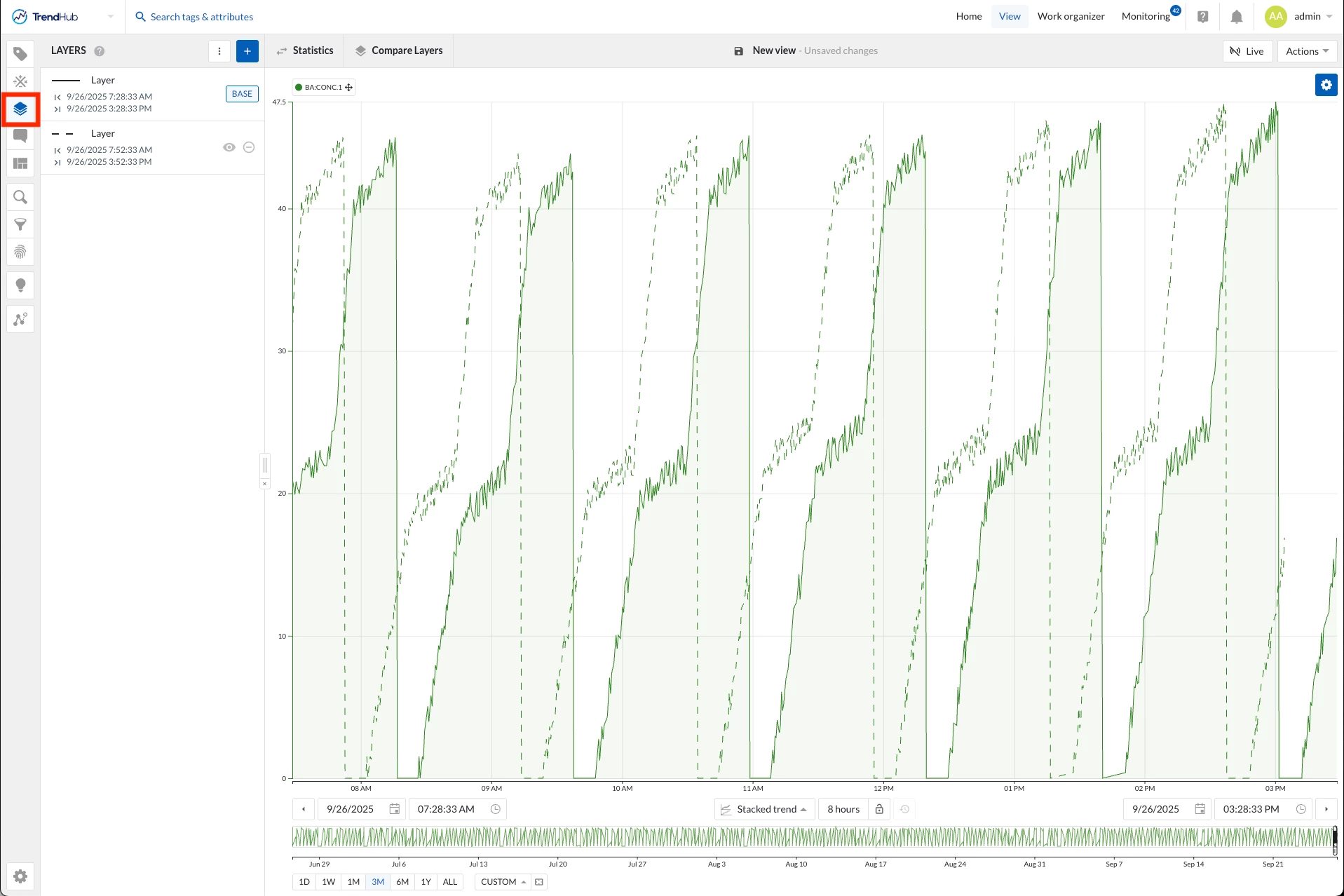

Hi ​@garchr01,

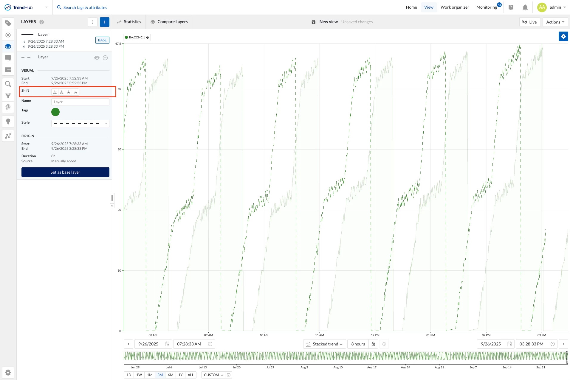

This can be accomplished by adding a layer. In the layers menu, you can manually add one (or more).
By clicking on the layer, you can shift it around to your needs.
Does this resolve your use case?

Hi Fréderick,
I didn’t know about the layering. I tried it. What I do encounter: I’d like to shift multiple layers up to 6 years in the past (a lot of clicking because I can’t enter the shift amount manually in layers).
Also, I can only change the style of the line, not the color, which makes it difficult to distinguish one year from another (I am looking at campaign data).
Lastly, I can’t stack the graphs using the layer approach. The layers are always over each other.

Ok, thanks. That would work normally, but I’m already 2 layers into calculations, so TrendMiner won’t allow me to create a duplicate, because I reach the limit of layers of calculation. I could put all my calculations into one formula.
Best regards,
Christian
