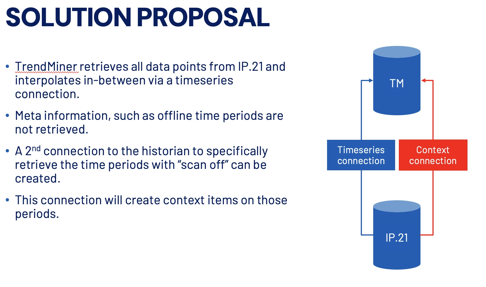

I can think of one workaround that might enable your use case, but it should be considered only if getting the information from your data source using ODBC isn’t a problem.
How?
We should be able to create context items through a separate context connection, via generic ODBC/JDBC. This connection would specifically request the metadata state. Once a tag goes bad, it should create context items for those periods.
I.e.:
What do you think?
