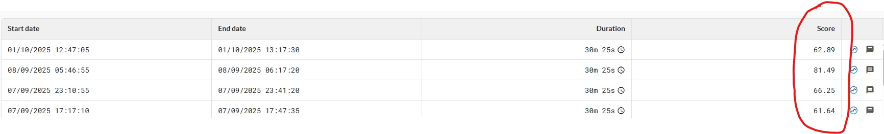

When a monitor is created to detect deviations of a given fingerprint, in the monitor gives an score on how adhered was the production run to the fingerprint, the difference is the deviation, how could this score be registered in a context table?
Score of fingerprint monitor
Thanks.

Hi Francisco,
Currently, it is not possible to write these scores back to context items from within TrendMiner. However, it should be possible to this by running a small external service that uses the TrendMiner APIs.
Let us know if you would like to have a quick sync on this topic!
