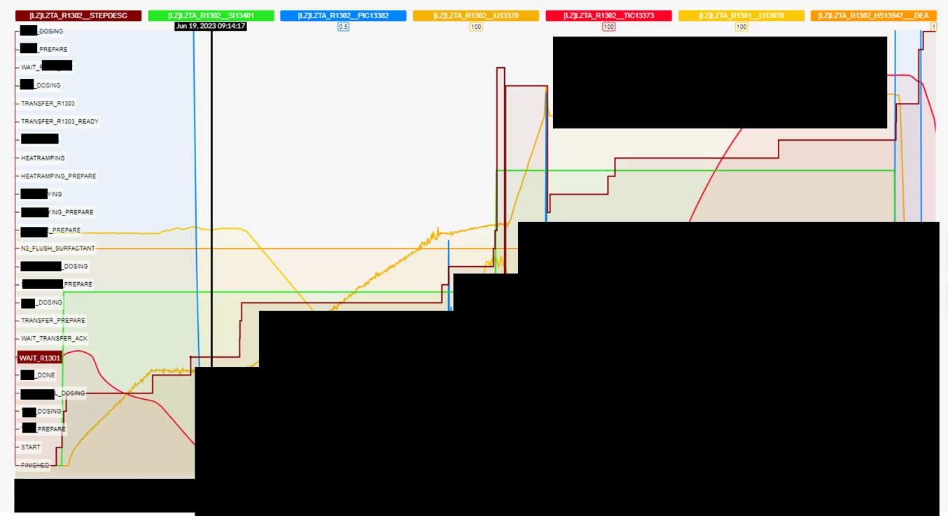

We run a batch process, in which each step has a numerical and text value. I have been able to plot with the Y-axis having the full description of the Step Description, like in the picture below.

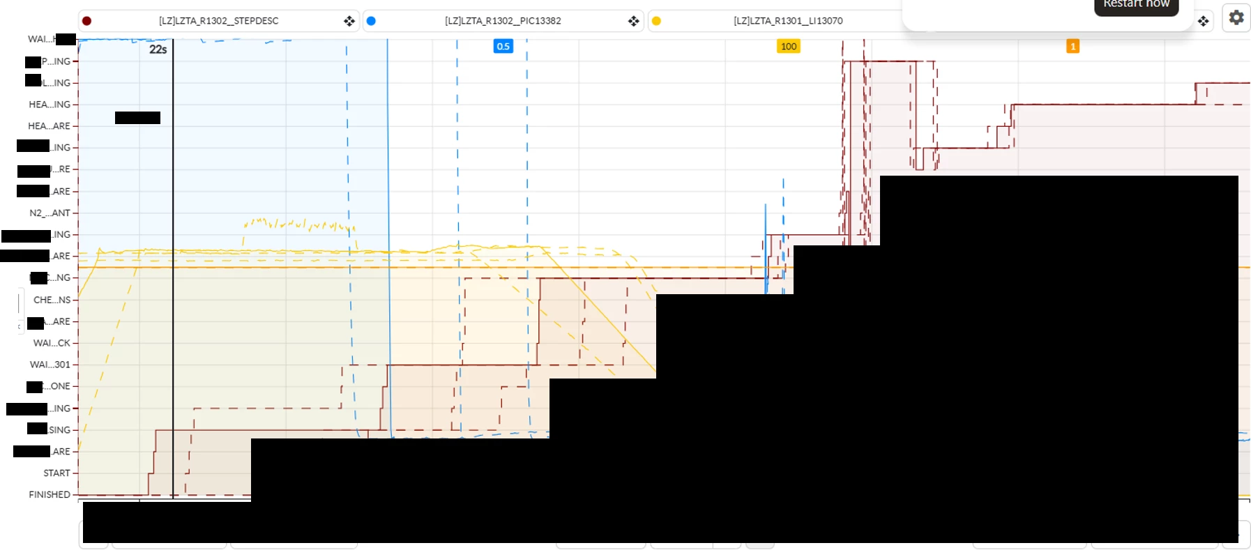

But recently, I can only see part of the name, not the full name. Do you know how to change back to full name?

Hi ​@Alberto.MartinezJoaristi
I can confirm your second screenshot is current behavior. When you hover over the labels, you will get a tooltip that shows the full step name.
Your first screenshot looks like it originates from an old TrendMiner version. Do you know which version this was taken from?
In any case, I understand the chart is a harder to interpret when you don’t see the full step names. I’m looping in our colleagues from the product team here, so they can take this feedback into account for potential future improvements ​@Jordan Biets  ​@Jo Warson ​@Jeroen Bouvin
