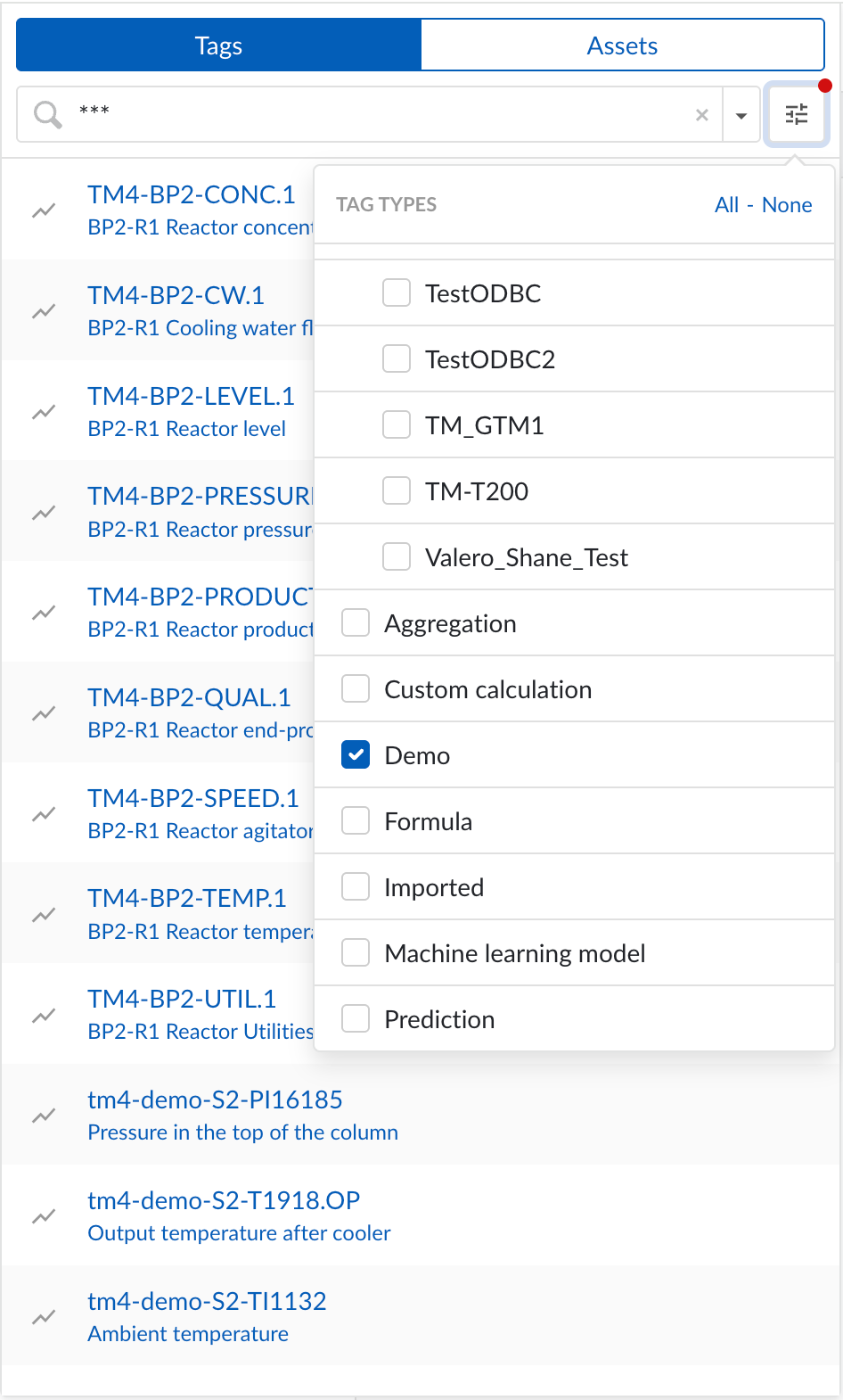

I could not find a list of the tags in the demo datasource in the documentation, nor a description of what data is in these tags over what time period. Is that available in some way?
And these tags are available to all users, right?
Reason to ask is to build localized training materials that are not dependent on user's permissions to ‘real’ tags
Best answer by Jef Vanlaer
Hello ​@Roger Palmen
To get a quick overview of the demo data tags in TrendMiner, you can use the filter option in the tag browser. Under TAG TYPES, only select the Demo option and then use *** in your tag query to list all available tags, as shown in this image:
Note that many of these tags are available in different time periods, indicated by the prefix (e.g., TM, TM4, TM5). We ship more recent tags on a regular basis to avoid having to go back into the past too much during trainings.
There is no full description of these tags available at the moment, but they are used in our Basic Guides and Intermediate Guides (https://userguide.trendminer.com/en/training.html) to illustrate typical TrendMiner Workflows. These Guides should form a good basis for your internal training.
Demo tags are indeed available to all users.
Kind regards,
Jef
Kind regards,
Jef

Thanks! I didn't know the *** trick to find all tags :-)
