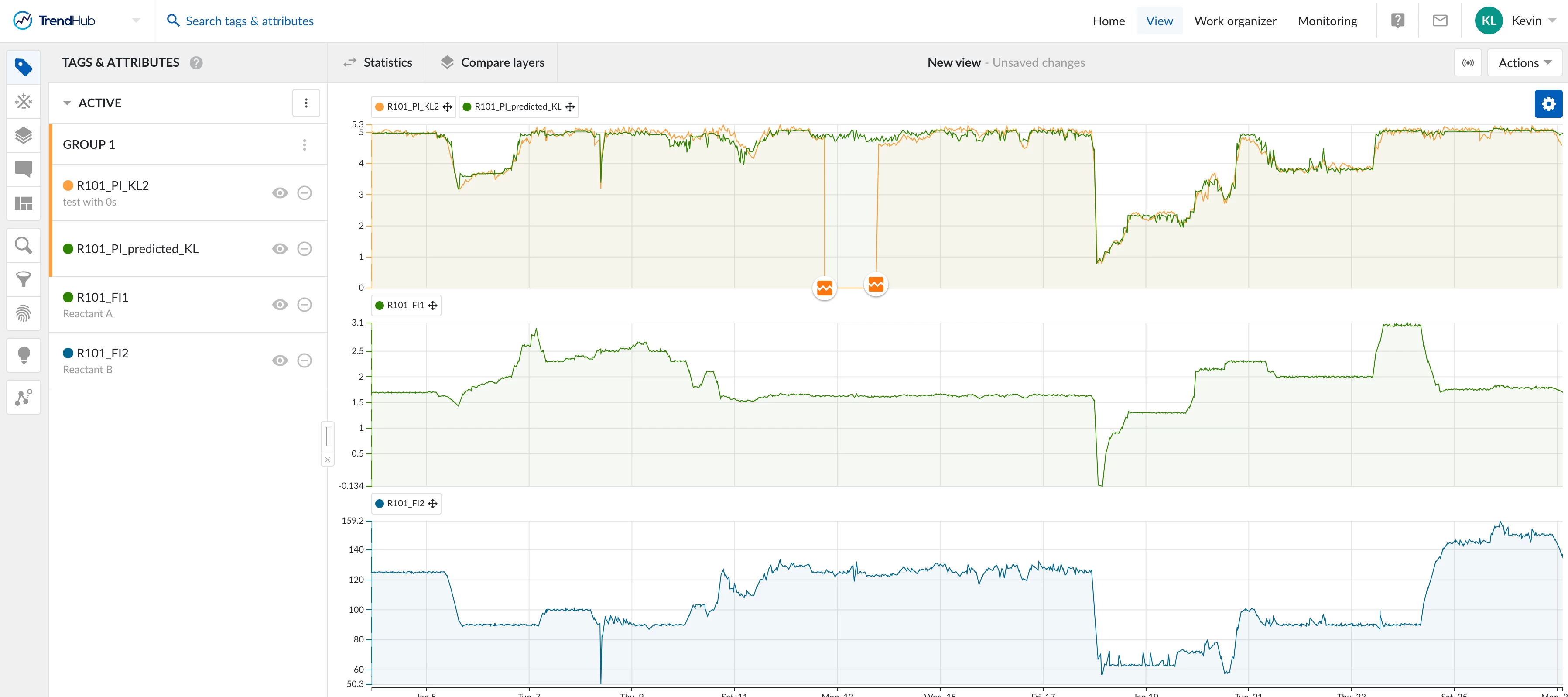

Solution
To address the challenge of predicting slow-sampled variables in real-time, we implement a soft sensor solution using TrendMiner's functionalities. The first step involves identifying the fast-sampled inputs that can serve as predictors for the slow-sampled variable, such as a lab value. These inputs are selected based on their correlation and relevance to the target variables.
Next, we use TrendMiner's machine learning capabilities in MLHub to train a predictive model using the selected inputs. The model is trained to accurately predict the slow-sampled variables based on the fast-sampled inputs, taking into account the process dynamics and interdependencies between variables.
Once the model is trained and validated, it is deployed in TrendHub, where it continuously updates based on the fast-sampled inputs and provides real-time predictions for the slow-sampled variable. Operators are able to access these predictions through a user-friendly interface, allowing them to monitor the process and make adjustments as needed to optimize operations and ensure quality standards are met.
By implementing this soft sensor solution, we are able to overcome the limitations of traditional sampling methods and improve our ability to predict and control critical process parameters in real-time.
