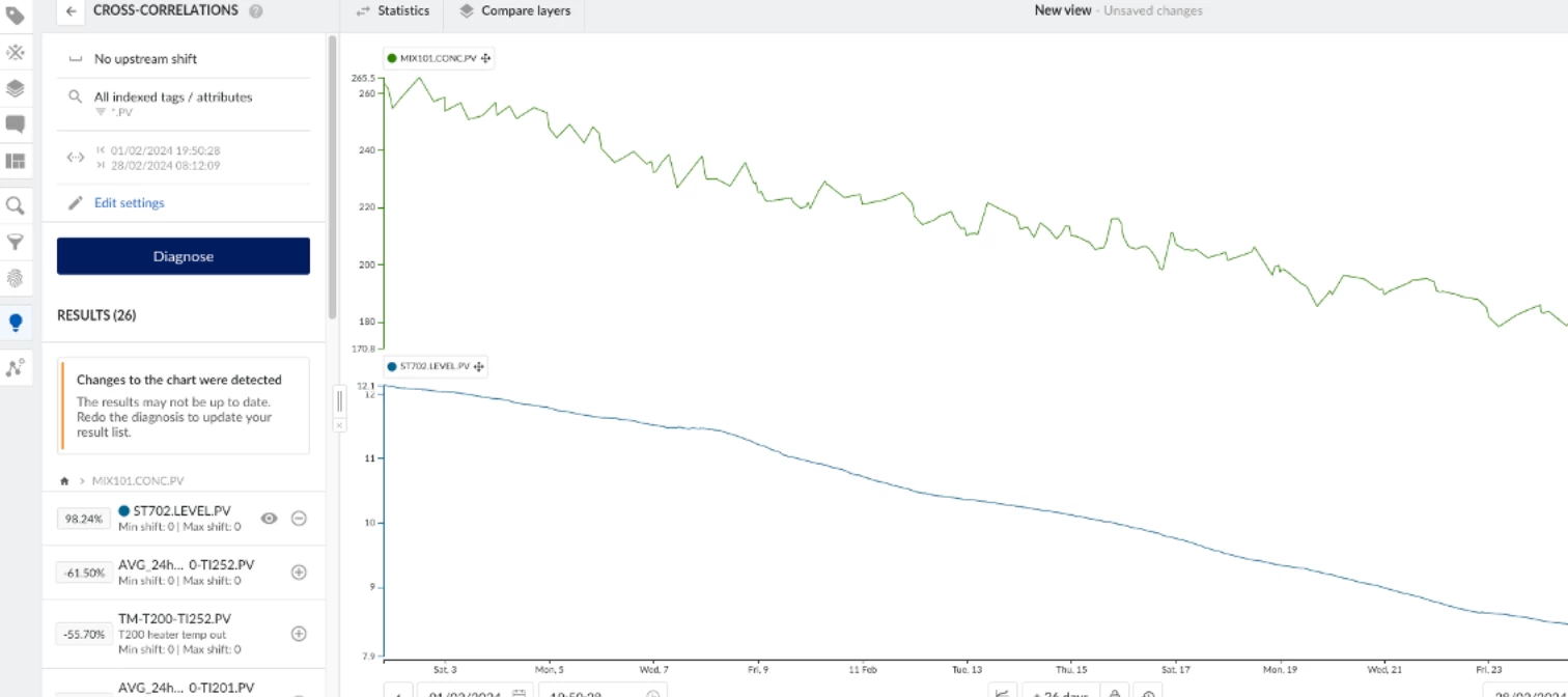

  1. Visualizing the problem
    The composition of the samples from the mixing tank was displayed in TrendMiner. Here we could clearly see the concentration of the solvent product decreasing, which is an obvious cause of the other product crystallizing. The question thus becomes: why are we receiving less solvent from our production process?
  2. Hypothesis generation
    Since there were no obvious hypotheses to check, we resorted to the Cross-Correlations functionality in TrendMiner, which allows for searching all tags in TrendMiner for correlations. Using this functionality on the slowly decreasing trend of solvent concentration yielded a significant correlation with the drop in level in a tank elsewhere in our process.
  3. Hypothesis investigation
    Zooming out in TrendMiner, we noticed that the level in this particular tank first sharply increased and then slowly decreased. This matches the addition of an external intermediate product to the process, which is then mixed into internally produced product in this tank. As this external product is processed and the level in the tank drops to normal levels, the solvent concentration downstream in our process decreases. This points to the addition of external intermediate product as a cause for the process issues. Looking at historic data when external intermediate product was added, the same issues occurred there, confirming this hypothesis.

TrendMiner cross-correlations identified emptying of a process tank as a potential cause of decreased solvent production, in turn leading to crystallization issues during mixing.
