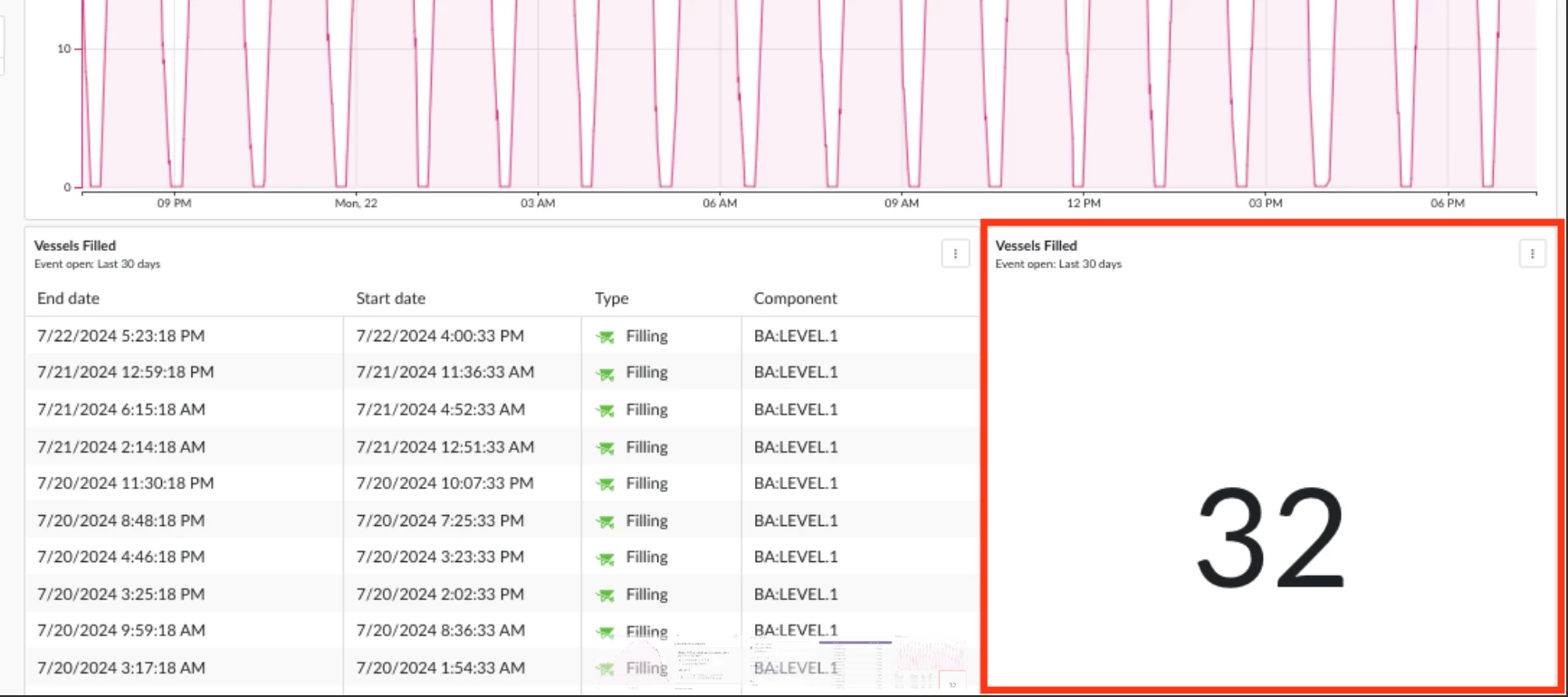

  1. Set up a monitor with context items to keep count of the number of trucks/railcars filled
  1. Create a ContextHub view to capture bin fills for the desired time period
  • Production is typically reconciled monthly. The time period can be adjusted using the Event Open button
  1. Add a counter tile to a dashboard for up-to-date values
