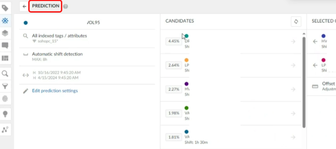

-Load all the related tags, as well as the key temperature
-Run the correlations engine to find correlations against the potentially correlated variables and against all the variables of the asset
-Layer 2 periods (high and low recovery) and compare statistics and trends of the potentially influencing parameters
Results and value
-Two process variables were identified as the main influencing factors.
-It was identified that both variables weren't acting at the same time, but separately. That's why by themselves, the correlation is not to high, but combined, the change in the temperature can be explained.
-A linear regression equation based on the 2 most influencing factors was built, to predict temperature (and thus, recovery) based on them.
