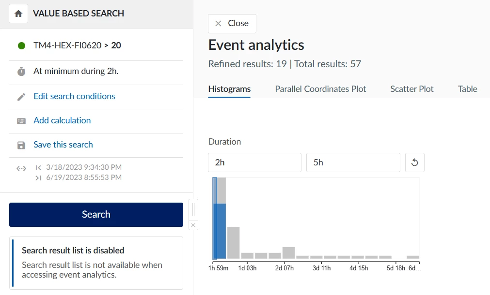

Option A: Refine Search Results by Duration Range
Use this approach to narrow down results after you’ve run your main search.
Steps:
  1. Run your event search based on the relevant value or digital criteria.
  2. In the search panel, click "Event Analytics".
  3. Set the minimum duration to 2 hours and the maximum duration to 5 hours.
  4. Your results list will now only show events that occurred within this defined time frame.
Tip: Perfect for quickly filtering without modifying your original search setup.
Search for events with a duration of 2 hours to 5 hours

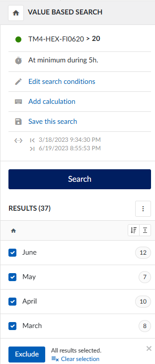

Option B: Exclude Longer Events Using a Static Filter
This method helps if you want to exclude overly long events before analyzing the data.
Steps:
  1. Start your search by setting a minimum duration of 5 hours.
  2. Save the result set as a static filter.
  3. In the filter, exclude all events with a duration greater than 5 hours.
  4. Combine this filter with your original search conditions — now you’ll only see events between 2 and 5 hours.
Helpful when building reusable searches or sharing with colleagues.

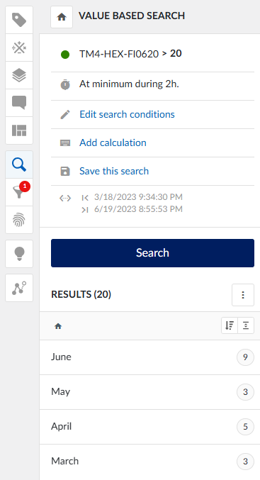

Search for events with a minimum duration of 5 hours and filter them out
Search for events with a minimum duration of 2 hours, taking into account the previously created filter
